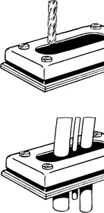

Fitting Instructions
- Fix base with gasket using self tapping screws provided
- Drill centre gland using a twist bit same size as the cable diameter
- Insert cable and screw top to base using the machine screws provided
