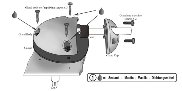

Fitting instructions:
1. Drill a clearance hole for the cable in the required location plus 3 pilot holes for fixings using the main body as the template.
2. Pass the cable through the gland cap cable entry hole.
3. Slide appropriate sized seal on to the cable and push up to cap.
4. Pass the cable through the gland body and using the 2 machine screws supplied, fix the gland cap to the gland body.
5. When secured, fix the complete gland assembly over the base gasket (with sealant around the fixings and gasket) in desired location using the 3 self tapping screws supplied.
